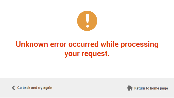

Also, if I just go to the page:
https://URL/sdpapi/request/TICKETID?TECHNICIAN_KEY=TECHKEY
Then I get this error:
Any help would be appreciated.
