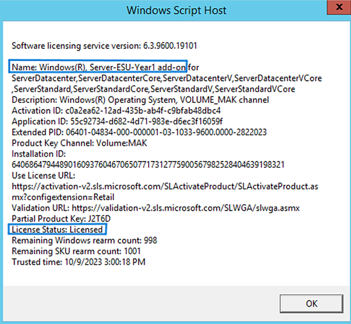

Steps to verify if ESU license has been activated successfully:
  • Open Command Prompt.
  • Execute slmgr /dlv <Activation ID> and then press Enter .
  • Verify the License Status. Ensure the status indicates Licensed for the respective ESU program.
