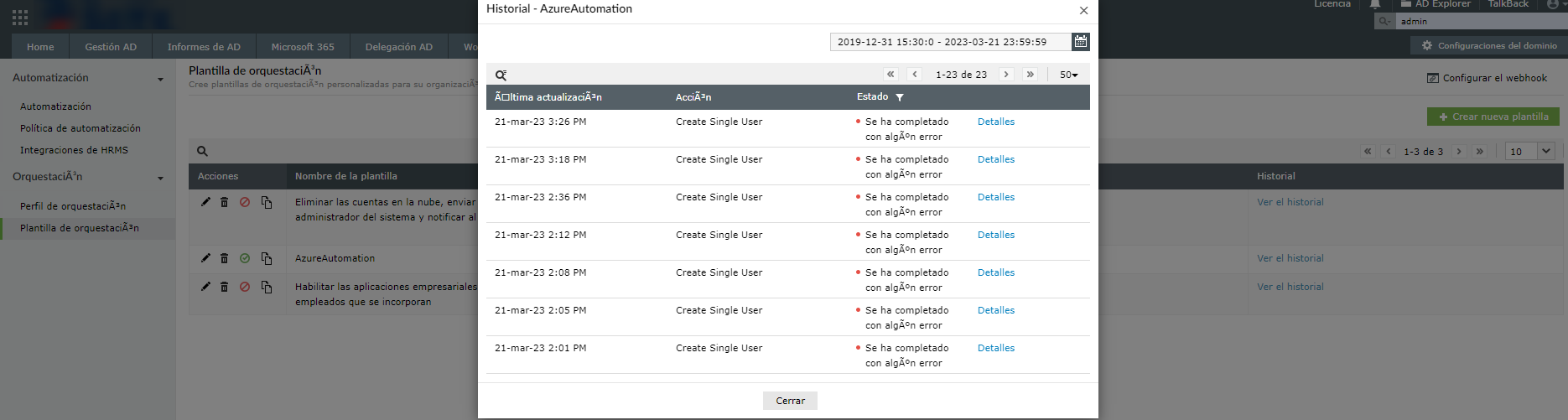

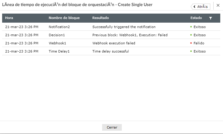

The problems is when i doing a test, webhook respond correctly.... In azure i see the Runbook and see all its working fine.... But at the moment that i need share the real information, using Orchestration template, the ADManager show an error and dont send nothing....
