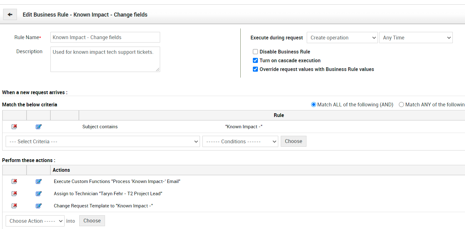

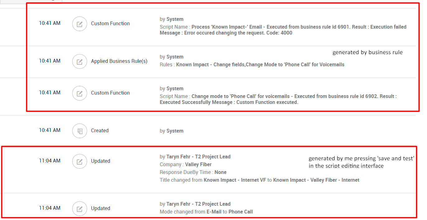

And it updates the request properly when I use 'save and test', however running the same code gives errors when triggered through a business rule:
Why does my code work in save and test, but not when triggered by a business rule? here's how one of the business rules is configured:
