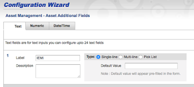

Whichever you choose you will undoubtedly be wanting to track such custom data as the IMEI number.  To do this would normally prompt the creation of a new custom field under Admin > Asset - Additional Fields:

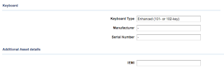

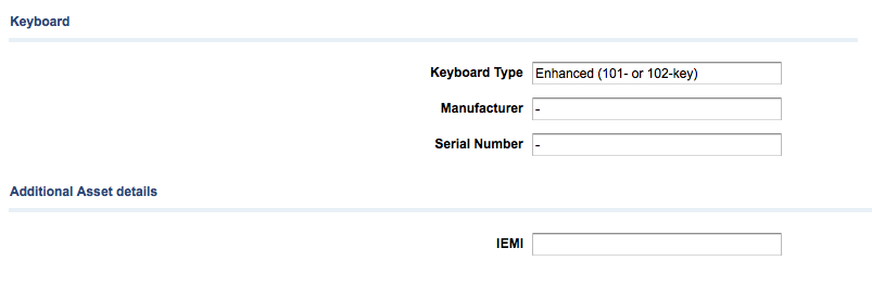

The trouble is this custom field has been added to  every resource in the asset register whether you want it or not. So if you edit a workstation, for example, you'll find a custom field for the IMEI number ... !

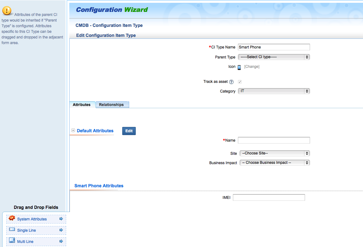

Here's where the CMDB module comes in. If you go to Admin > Configuration Item Types and select 'Smart Phone' you are presented with the ability to edit the attributes of the CI Type:
The section we are interested in is the 'Smart Phone Attributes'. You should notice a 'drag-and-drop' field selection tool to the left. Using a 'Numeric' Drag and Drop field you can then create an custom field for IMEI data, as shown in the picture above.

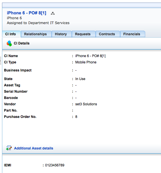

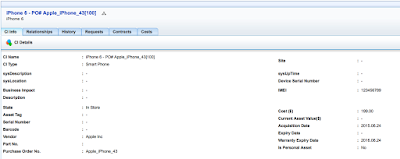

Now when you look at the asset details of a Smart Phone asset you will see the IMEI field data is contained in the body of the main asset data not tucked away at the bottom:
What's more you won't see anything to do with IMEI in any other asset record.  Cool huh?
