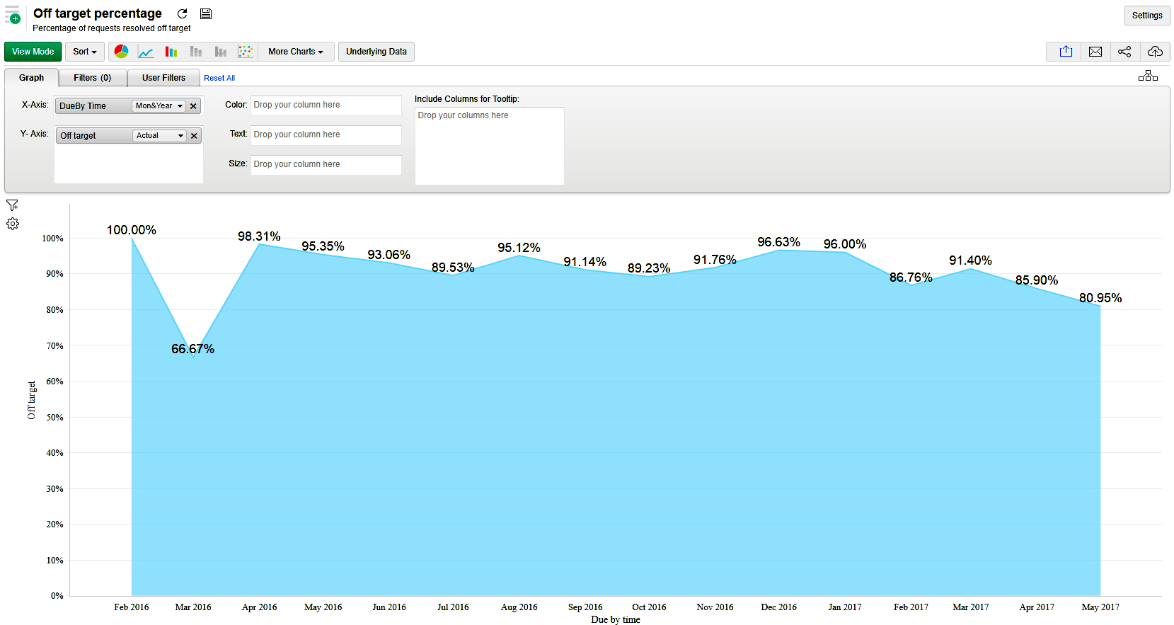

1. By calculating your off target percentage
In the following report, each data point represents the percentage of requests that were not resolved in the same week as they were due. For example- 80% off target signifies that only 2 out of 10 requests were resolved in the week they were due. The lower the percentage, the closer you are to your target. Also, analyzing reasons behind your off target set could give valuable clues to avoid delays in the future.

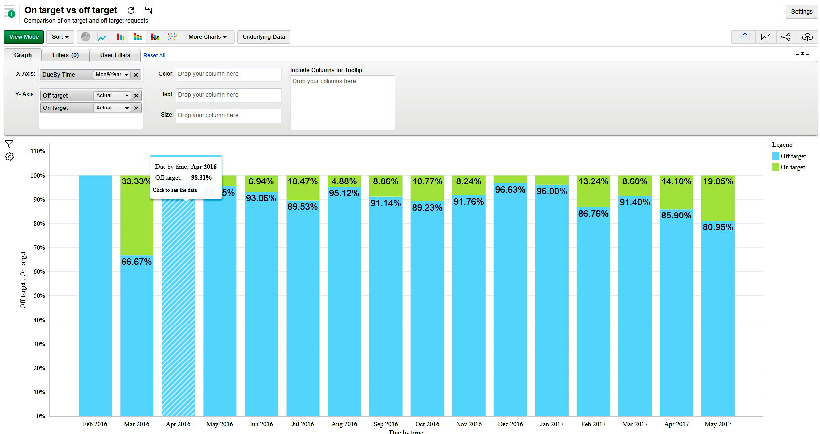

2. Representing the on target and off target percentage in the same report
This is a slight variation of the previous report. This includes the percentage of requests resolved on target and percentage off target

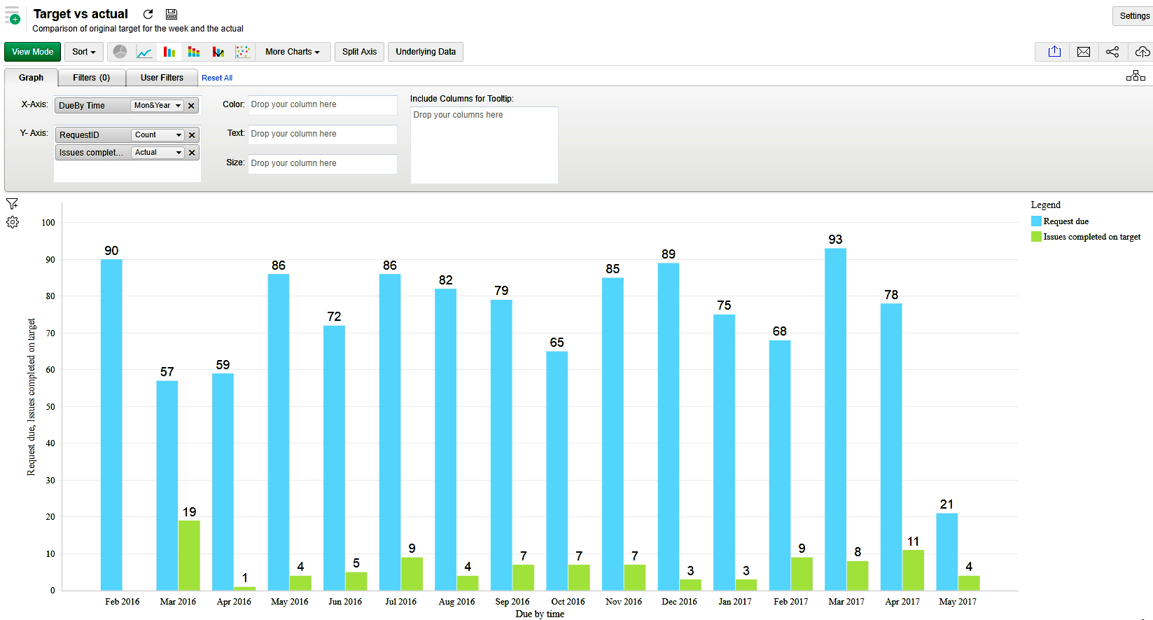

3. By comparing your target with the actual numbers
In the following report, you have two data points for each month. The green bar represents the total number of requests that were due in a particular week. In other words, this is your target. The blue bar represents the number of requests that were actually resolved. Comparison of these two bars will show you how far you're off target.
Steps to replicate this report yourself-
You will need these formulas to create these reports. Click here for text instructions to create formula fields.
% Off target - ((count("Request"."RequestID")-Countif(absweek("Request"."Resolved Time")=absweek("Request"."DueBy Time")))/(Count("Request"."RequestID")))*100
% On target - ((Countif(absweek("Request"."Resolved Time")=absweek("Request"."DueBy Time")))/(Count("Request"."RequestID")))*100
On target count - Countif(absweek("Request"."Resolved Time")=absweek("Request"."DueBy Time"))
