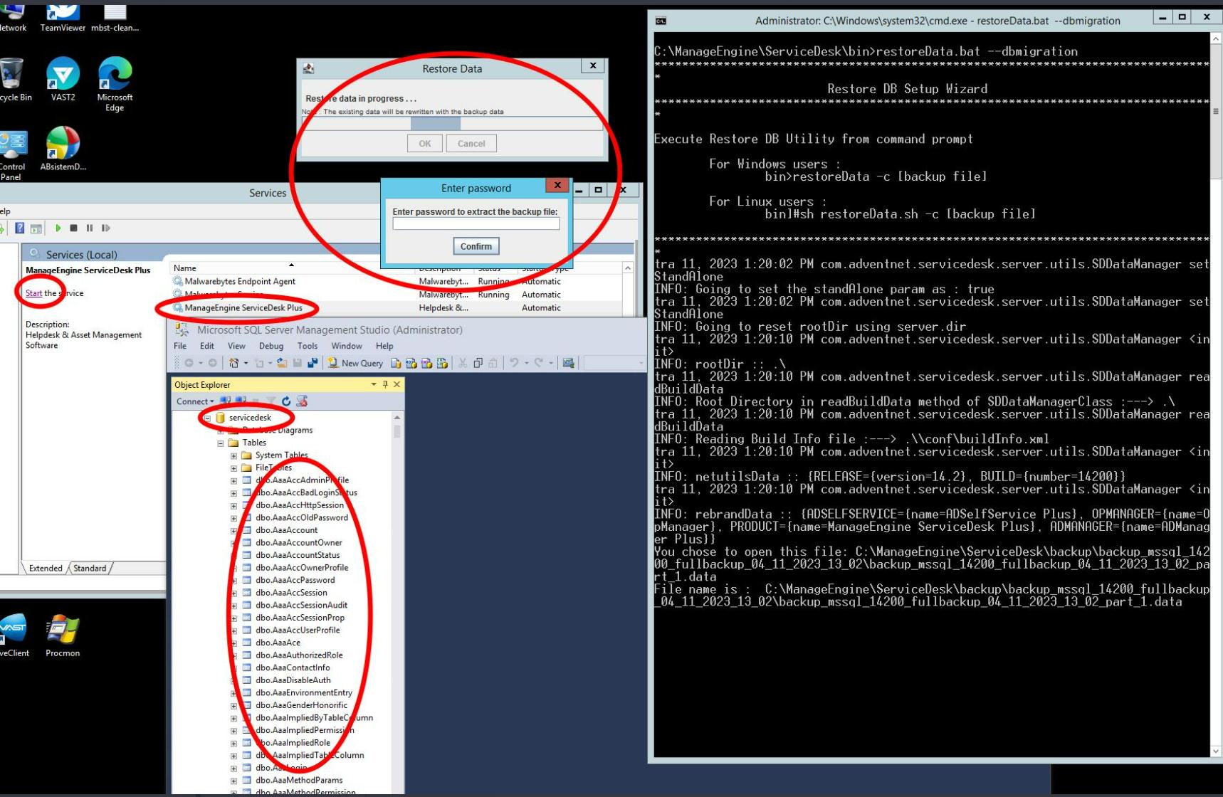

We have v 14200, hosted on our premises.
I did a full backup from command line, it backups fine to Postgree format.
All steps to migrate were executed in good order ( the db in SQL server is created, tables are empty but present ), the "backupDataOld.bat" script was executed, in order to compile a mssql backup file ( since Postgree and sql are not inter-compatibile ).
Executing the "restoreData.bat --dbmigration" script it asks for mssql backup, and when pointed to, it asks backup pwd.
No pwd works.
I even restored all from original backup, in order to go back to Postgree situation, and in that working installation changed the backup files pwd to something trivial ( i.e. 1111 ), and then started the migration again.

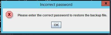

No change in situation, when restoring the mssql backup for import in sql server db, it asks for backup pwd.
Also the SDP123! pwd is not working ( along with the configured one ( 1111 ) ).
Basically, I managed to do everything, but when restoring it asks for pwd which is unknown.
Kindly advise.
