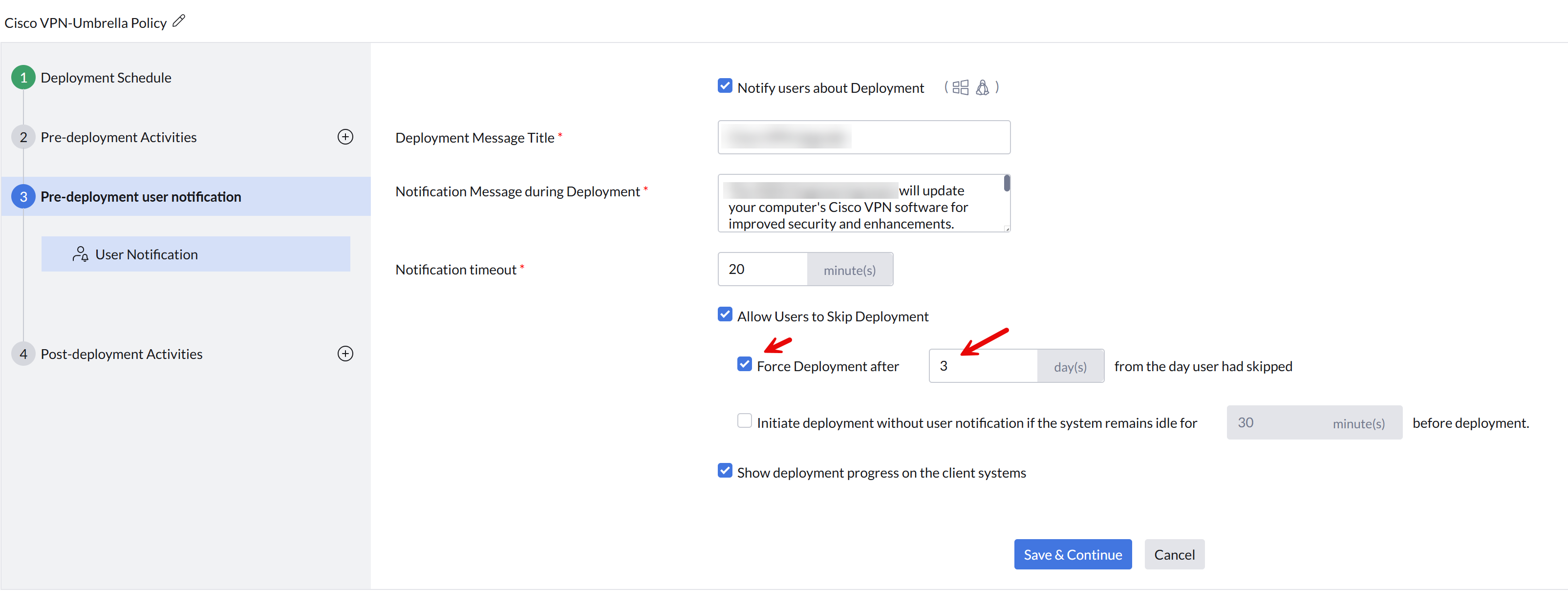

I'm testing software deployment options and I created a deployment policy that allows the user to Skip but forces the install after three days.
It's being deployed to Users and Run As System Account for the software installation.
First issue - On a test device I selected Skip but it installed anyway right after I selected Skip.
Second issue - On another test device I selected Skip and the 10 minutes later it popped up asking to install again appeared.
Third issue although probably not an issue technically speaking.  It would be nice if I could select a Dynamic Custom Group for target exclusion.
I'm concerned that with the inconsistent behavior that I see that I won't be able to use the functionality of "Allow Users to Skip Deployment".
Am I going wrong here somewhere?
