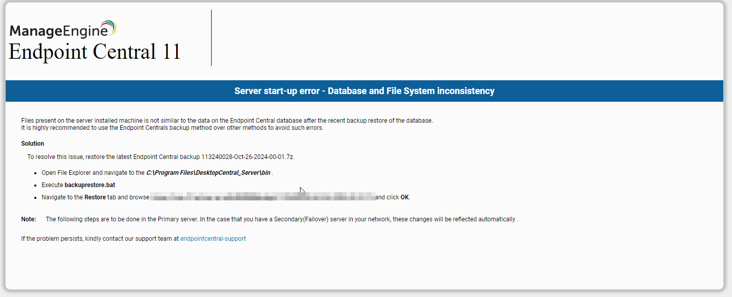

  1. Database and File System Inconsistency Errors:
    • After applying the new license file, the following day we began seeing errors related to "Database and file system inconsistency" upon starting the EPC server.
    • The error message indicates that this issue occurred after a “recent backup restore of the database,” though no backup restoration took place when this error originally started happening.
    • We followed the recommended repair steps provided on the error page, allowing the so-called repair to run for 24 hours, but eventually cancelled the process as there was no sign of completion or resolution.
