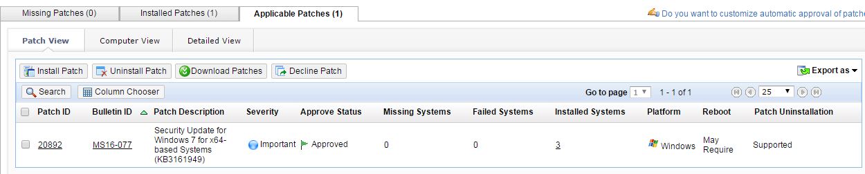

I've come across something strange.  After running Nessus on our workstations recently, we found none of them had the MS16-077 Security Update installed on them.  I thought this was strange since virtually all our computers showed as Healthy with no missing patches in DC.  So I tried searching for the patch in DC but it wasn't there.  I found if I loaded the update manually on computers, DC does recognize the patch and it shows as approved (see below).  Yet it does not indicate it is missing from any computers.  I found the thread stating that this update is supported within DC.  Has anyone else had this issue?  I'd really prefer not have to deploy it on my own since it should have been included along with the other patches in our daily patch deployment process.  Just looking for any ideas.  Thanks!
