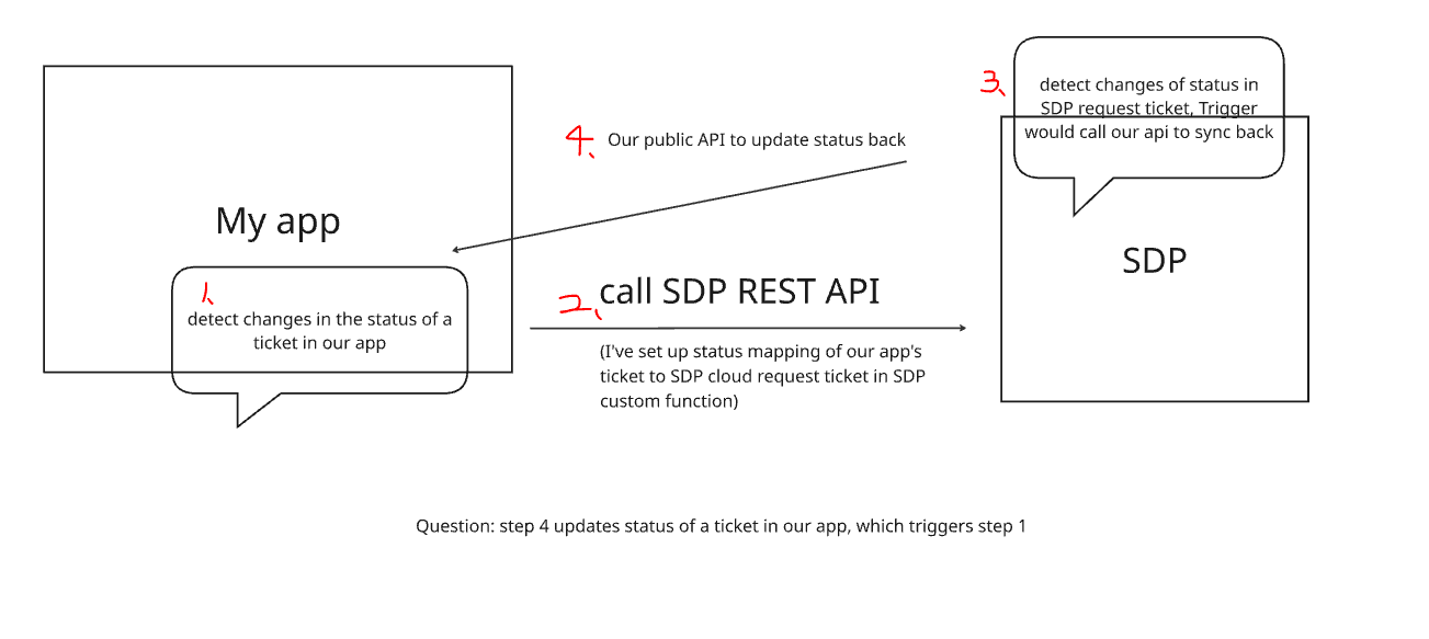

I'm working on a bi-directional sync between our company's app and SDP Cloud.
Flow:
  • App → SDP: Using SDP Cloud V3 API (edit-request) to update ticket status.
  • SDP → App: Using Triggers + Custom Functions to detect status updates and call our public API.
Problem:
Because the sync is two-way, when SDP updates a ticket and triggers the sync, our app updates it back to SDP — causing an infinite loop.
What I need
I want a way to send an internal flag/mark when calling edit-request API, such that:
1. The flag exists only for that update call, not permanently stored as ticket property.
2. When Trigger executes and Custom Function runs, I can check this flag.
3. If the update originated from our app → the flag exists and custom function checks the existence of this flag thus skipping callback to our API.
4. If the update is from SDP cloud UI -> the flag doesn't exist and custom function didn't find the existence of the flag and thus syncing back to our company's app.
What I tried
- Added udf_fields.some_flag during request creation
- However, UDF fields become part of ticket data, so Custom Function can still read it — not suitable as temporary flag.
Diagram to illustrate:
Question
Is there any supported way to:
  • send a temporary flag/metadata with request update API, or
  • detect if an update was triggered by API (vs UI/user input), or
  • mark API-originated updates so triggers can conditionally ignore them?
Any workaround/alternative design is welcome.
Thanks in advance!
