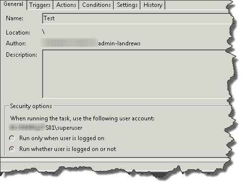

Some of our servers have scheduled tasks running as the local admin password.

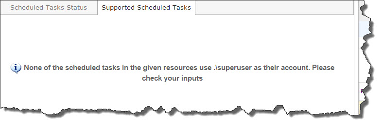

I've added the server as a resource and I've added the local admin account as an account and verified that the password is in sync.
If I select the account and click "scheduled task" PMP checks if any scheduled tasks are running using the account.  it says there are no tasks running.
There is a task scheduled on the server
but when I reset the local admin password the scheduled task is not updated and fails.
Am I doing something wrong?  I've done the same test for a domain account and it works fine.  Just not for local accounts.
