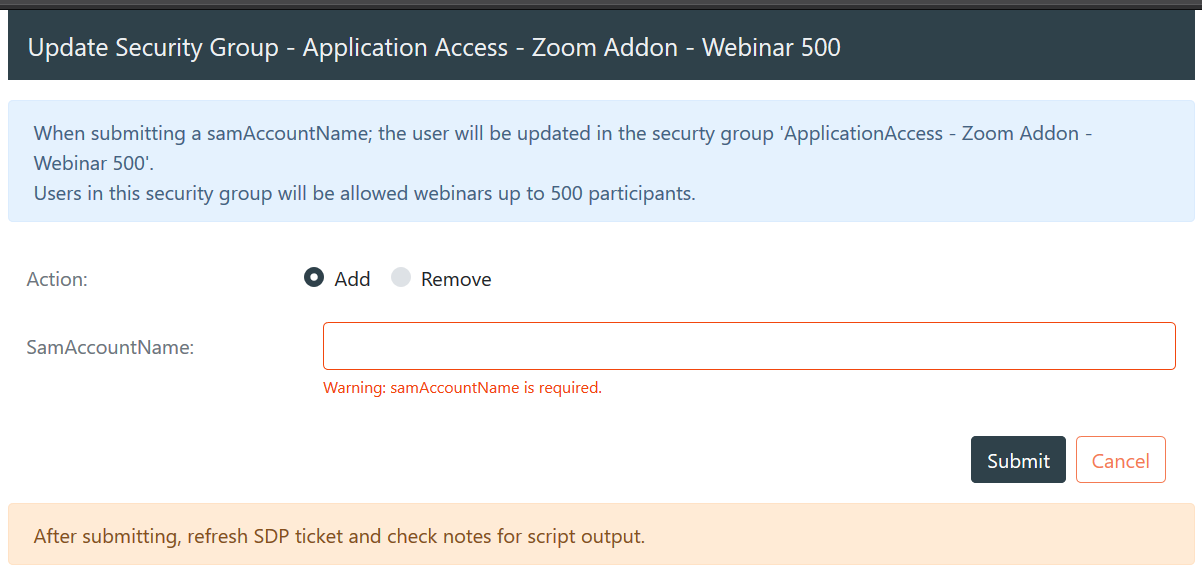

Sample will allow user to input samAccountName and Add\Remove and the script will check to see if there are spare licenses for Zoom and update the security group if required.
Users select the drop down 'Custom Actions' in the ticket and run the required script.
This HTML form is presented to the technician to update
On submit the Action and samAccountName are passed to powershell script and processed.
Using API the script will update the notes in the ticket with the result.

Custom HTML File: Sample_Custom_Menu.html
Action Type: Execute script
Script file to run: Powershell.exe -f Sample_Powershell.ps1 $HTML_DATA_JSON_FILE -ExecutionPolicy ByPass
