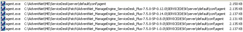

1) from the SD+ server, we took the agent.exe from this path
C:\AdventNet\ME\ServiceDesk\Patch\AdventNet_ManageEngine_ServiceDesk_Plus-7.5.0-SP-1.0.0\SERVICEDESK\server\default\conf\agent

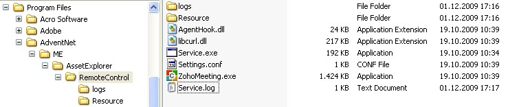

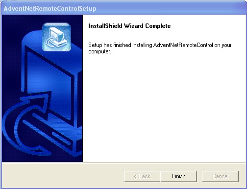

2) we installed the agent successfully on a workstation using administrator rights.
The agent has been installed under C:\Program Files\AdventNet\ME\AssetExplorer\RemoteControl
3) When trying to start the Service.exe; a log file Service.log is created and contains following error:
