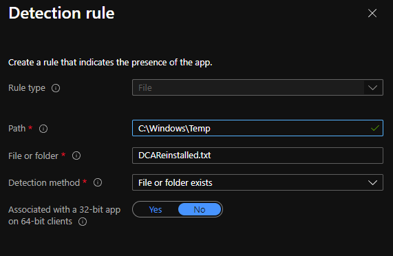

    #This is optional, it generates a text file to use for Intune detection rules (can't use product code or registry since it will already exist prior to reinstall)
    New-Item C:\Windows\Temp\DCAReinstalled.txt

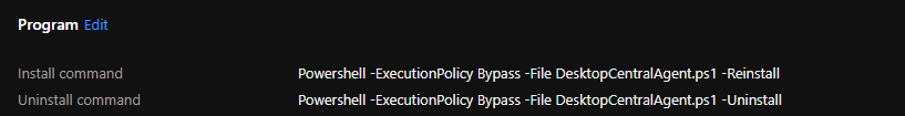

From here, go to Intune and create a new Win32 app, uploading the intunewin we just created. If you're doing this for the purpose of re-installing Desktop Central Agent, then for the Install command you'll use:
  1. Powershell -ExeuctionPolicy Bypass -File DesktopCentralAgent.ps1 -Reinstall
For the uninstall command, we can use:
  1. Powershell -ExecutionPolicy Bypass -File DesktopCentralAgent.ps1 -Uninstall
For detection methods, manually configure it to look for the file C:\Windows\Temp\DCAgentReinstalled.txt
Then assign away!
