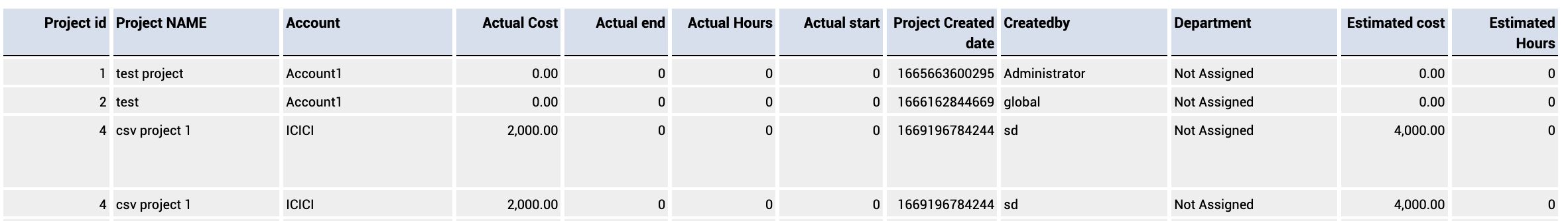

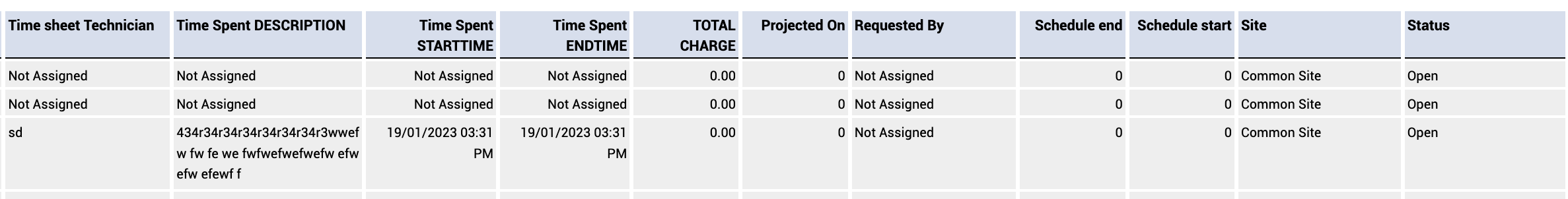

Query to get Project and worklog detailed information
Version : 13000
DB : PGSQL
OUTPUT:
SELECT projectdet.PROJECTID AS "Project id",
projectdet.TITLE AS "Project NAME",
ad.ORG_NAME AS "Account",
projectestimations.TOT_TASKHOURS_COST AS "Actual Cost",
projectdet.ACTUALENDTIME AS "Actual end",
projectestimations.ACTUALTASKHOURS AS "Actual Hours",
projectdet.ACTUALSTARTTIME AS "Actual start",
projectdet.CREATEDTIME AS "Project Created date",
projectcreatedby.FIRST_NAME AS "Createdby",
deptdef.DEPTNAME AS "Department",
projectestimations.ESTIMATEDCOST AS "Estimated cost",
projectestimations.ESTIMATEDHOURS AS "Estimated Hours",
projectowner.FIRST_NAME AS "Owner",
projectprior.PRIORITYNAME AS "Priority",
projectdet.PROJECTCODE AS "Project Code",
projectdesc.DESCRIPTION AS "Project Description",
projecttypedef.PROJECTTYPENAME AS "Project Type",
worktype.name AS "WorkLog Type",
rctd.FIRST_NAME AS "Time sheet Technician",
ct.DESCRIPTION AS "Time Spent DESCRIPTION",
longtodate(ct.TS_STARTTIME) AS "Time Spent STARTTIME",
longtodate(ct.TS_ENDTIME) AS "Time Spent ENDTIME",
ct.TOTAL_CHARGE AS "TOTAL CHARGE",
projectdet.PROJECTEDEND AS "Projected On",
projectrequester.FIRST_NAME AS "Requested By",
projectdet.SCHEDULEDENDTIME AS "Schedule end",
projectdet.SCHEDULEDSTARTTIME AS "Schedule start",
projectsitename.NAME AS "Site",
projectstatus.STATUSNAME AS "Status",
TO_CHAR(((sum(ct.TIMESPENT))/1000 || ' second')::interval, 'HH24:MI:SS') "Time Spent",
longtodate(ct.CREATEDTIME) "Time Spent date",
propmau.FIRST_NAME "Project Member",
AaaLogin.name "User Name"  FROM ProjectDetails "projectdet"
