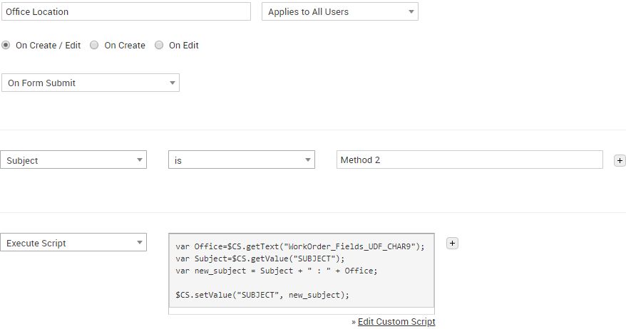

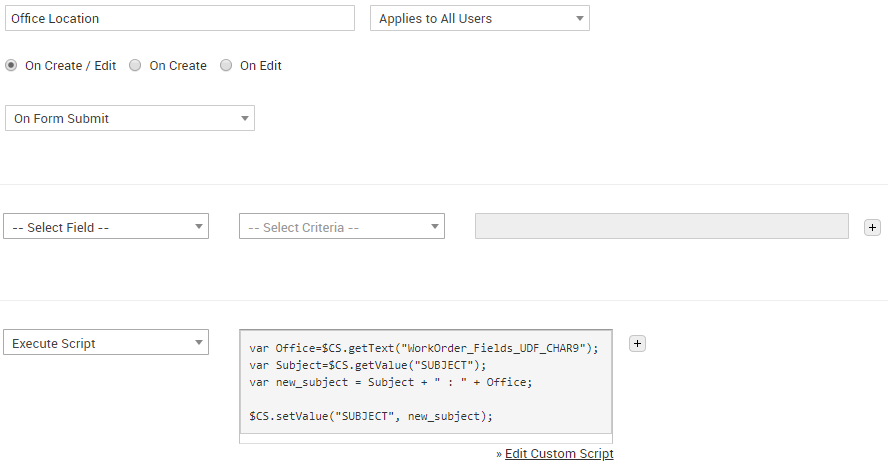

In this case, I don't need it to trigger by a specific condition, so that field can be left blank.  The issue is the condition impacts the output of the script on the subject line.  Below are two examples:
Method 1:
Method 2:

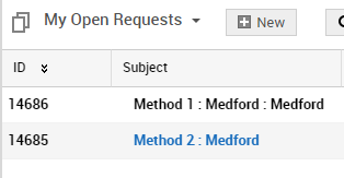

The resulting tickets appear as follows:
So, when I designate exactly what the subject will contain, it adds the office location only once.  If I don't specify exactly what the subject will be, it gives me the office location twice.  Depending on the settings, I've even had it appear three times.
To be clear, the only way I've been able to give me "Method 2"'s results is via setting the specific subject.  I've tried various other combos and none of them have worked.
