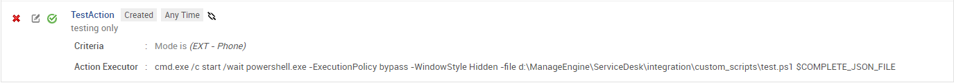

So, I'm trying to set up adding an approval and sending the mail via Powershell script as a Custom Trigger.  My SD install in on prem, and version 10.5 (build 10506).
There's good news here.  The custom trigger itself is working.  It looks like this:

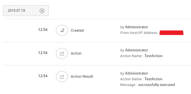

I know that the powershell script does in fact run, because I added some code to send myself an email with the ticket number as a test, and while that code is in the script, I get an email with the ticket number.  I can also look at any of the requests which meet the trigger criteria and I see this in the history:
