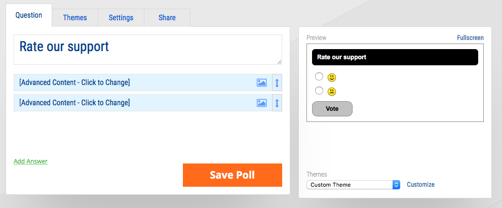

Creating a poll couldn't be simpler, just enter your question and then decide what answers you wish to provide - the preview screen on the right shows you what your poll will look like:
In the example above we used the advanced editor option on each question and used the 'smileys' available in the editor. If you want a larger smiley you can choose to upload your own graphics to each question :0) There are also plenty of options to save and create your own themes for displaying the poll.

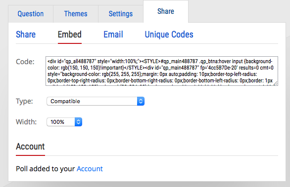

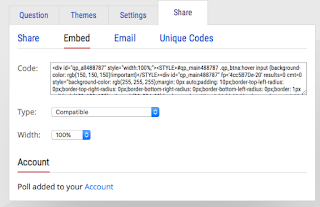

Once you've got the poll looking how you want the 'Settings' tab defines a range of options for controlling how the user interacts with the poll and whether they will be able to see the running poll results. Finally the 'Share' tab gives you a range of options for sharing your poll. In this case we used the 'Embed' options sub-tab to obtain suitable code for embedding in an HTML page:

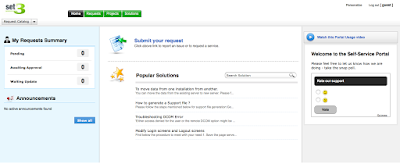

It's then simply a case of taking this code and adding it too the 'SelfServiceHelp.html' file in the '\custom' folder on the ServiceDesk Plus application server. The result could look something like this when logging on as a requester to ManageEngine ServiceDesk Plus:
