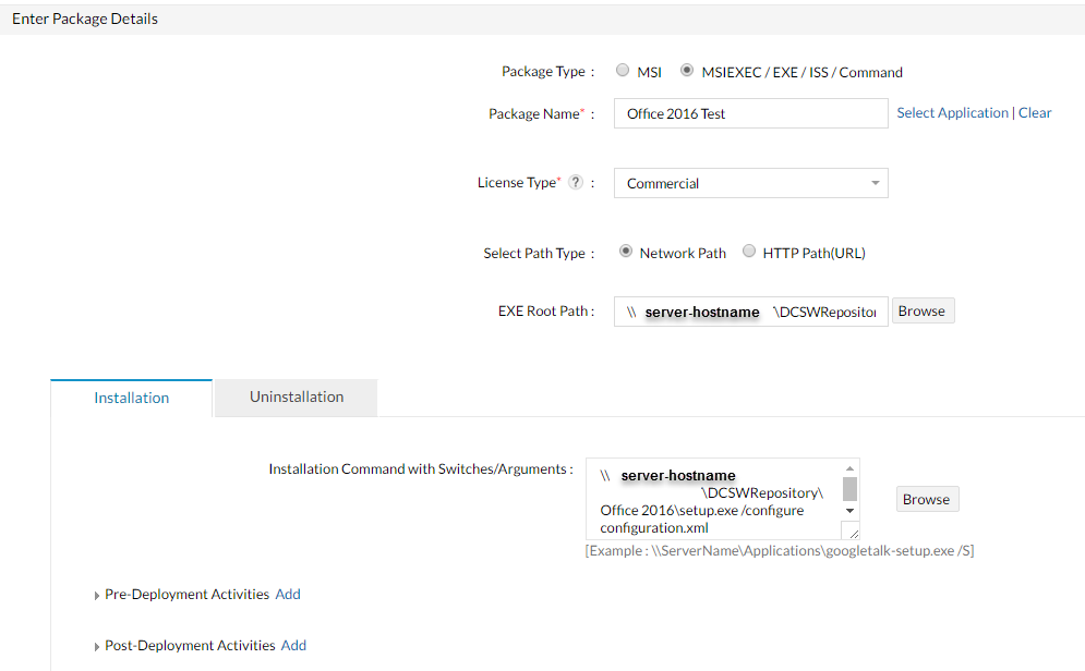

This is my configuration package that is being deployed, interested if anyone else has had any successes or is able to deploy using an alternate method.
