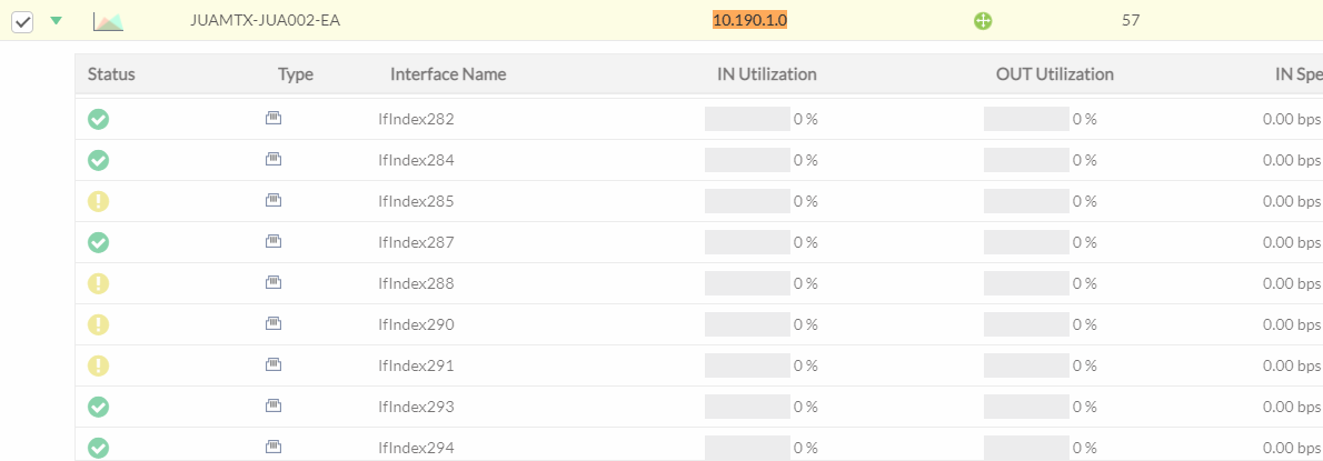

NEtflow Analizer error fetchin Nokia ALU Intefaces Names.

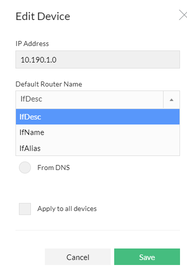

When I try to fetch names from a Nokia ALU but is not possible.
I Did already a snmpwalk and I can see the index are diferent to the GUI.

Also I tried all options possible to fetch the name
Thanks
