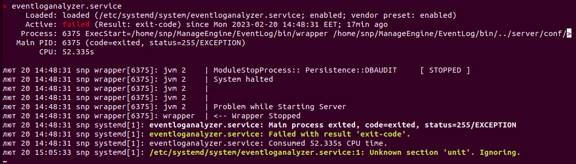

Hello. I have virtual Ubuntu 22.04 (ESXI). I installed EventLog Analyzer Server and ran it. The first-time server doesn't install like the service, but after manual installation, all went well. I run the service and logged in through my browser correctly.
Unfortunately, the service failed when I try to make any changes, like changing an initial password or seeing the interface feature.
Failed service
In this case, I run this service again and after several simple actions, I the service failed again.
