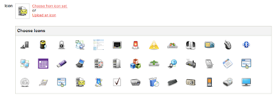

As shown the other element that has a great deal of resonance with the user is the icon displayed in the Service Catalogue against the Service Category, a picture is worth a thousand words after all! Now the icon set that is provided in ManageEngine ServiceDesk Plus by default is very IT centric and not much use in this scenario:
So where did the aeroplane icon come from? Simply by uploading an alternative icon graphic. To do this you will need to capture and generate a 64 pixel by 64 pixel graphic in JPEG, GIF or PNG formats. Most of us have access to a paint application in some form or other so this shouldn't be difficult to do. Hence the aeroplane icon seen above.
