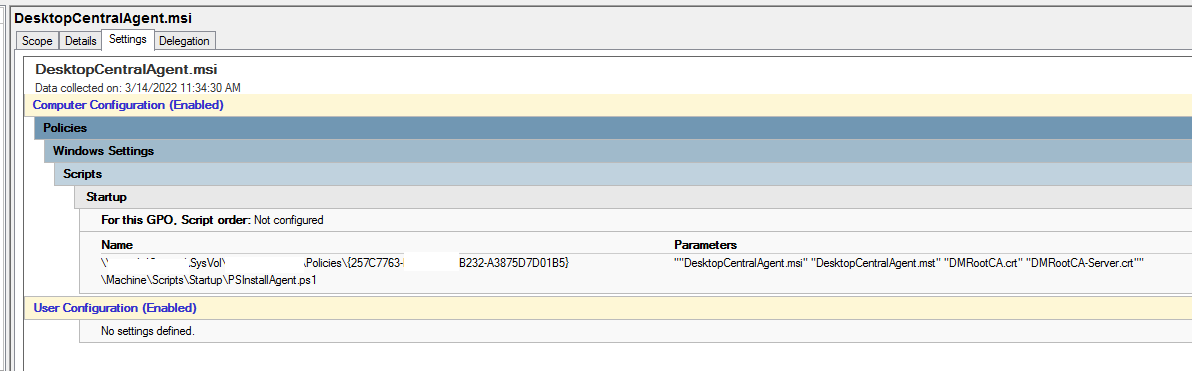

I followed the instructions in the URL below to create a group policy that will install the Manage Engine client to Servers contained within the OU within my organization that contains most of our servers.
https://www.manageengine.com/products/desktop-central/agent-installation-using-gpo-lightweight-tool.html
We have rebooted several of these servers and this group policy has successfully installed the Manage Engine client on these servers since this group policy is set to install the Manage Engine agent during Startup.

The current group policy that installs the Manage Engine agent on the target computers is listed in the attached screenshot:
GPO that installs Manage Engine client
