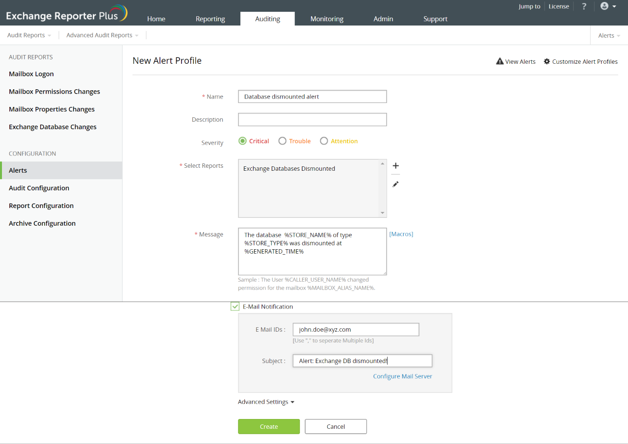

To set the solution for you to receive a notification:
  1. Go to the Auditing tab.
  2. Click the Alerts link.
  3. Select the New Alert Profile button.
  4. Enter a name and description for the alert.
  5. Choose the severity level.
  6. Click the + button near Select Reports and select the Exchange Database Changes reports category.
  7. Select the Exchange Stores Dismounted report from the reports displayed.
  8. Use the macros and enter the message you want the alert to be accompanied by.
  9. Select the Email Notification checkbox if you want email notifications.
  10. Click Create.
                                                                                                                 Figure 1: Receive an alert if a database is dismounted.
The next time a database is mounted or dismounted in your organization, you will receive an alert the same instant.
