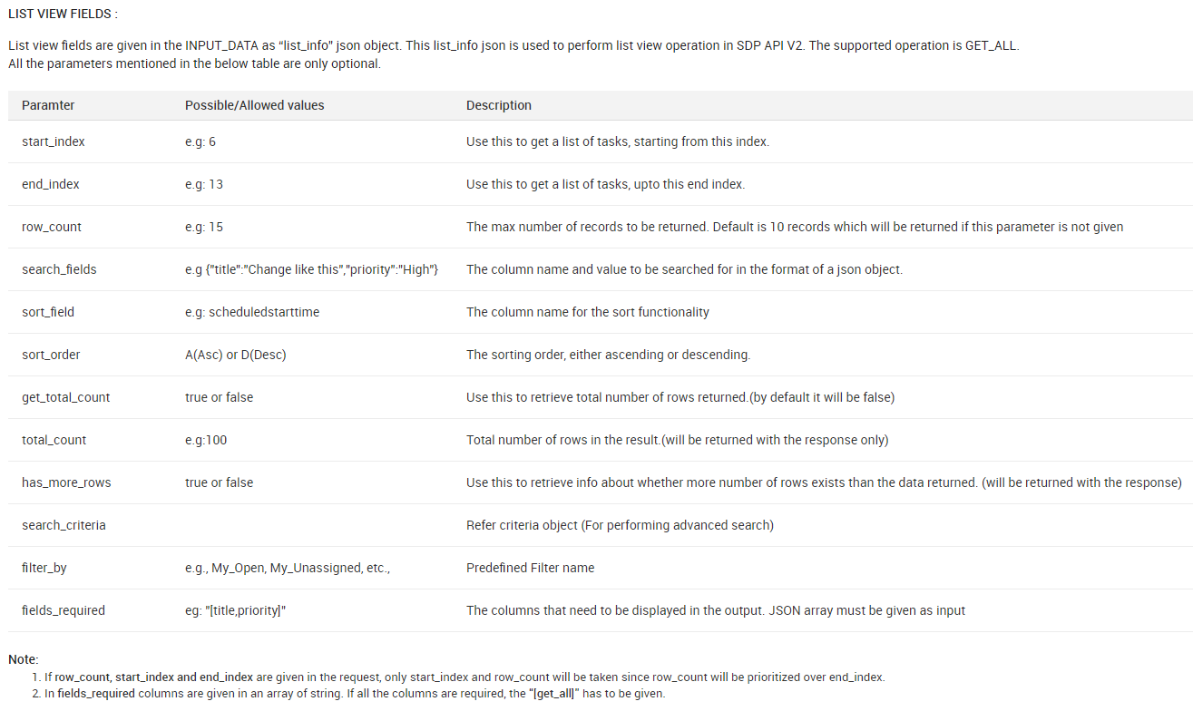

Ok, the above INPUT_DATA pulls all the open tickets for a custom view. But how do I include all properties of a ticket. Our documentation claims that a "fields_required": "[get_all]"
should be returning all properties of a request. however, the response fails.
"fields_required" is listed at the bottom of the attached screenshot.
adding "[get_all]" as shown below fails.
