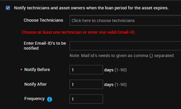

In enabling the built in notification option, we aren't just able to sent the notification to the user, we have to choose to notify technicians as well, and also choose a static technician to also send every notice to:

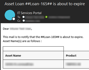

Once enabled, the notifications work but they end up getting sent to three people: the asset owner, the technician who created the loan originally, and the technician specified in the notification settings:
I can't understand why we're forced to notify the loan creator, and a static technician. We often have 50+ devices on loan at any time and this would result in a huge flood of e-mails for the static technician, and unnecessary e-mails to each technician who created the loans.
It also includes them on the same e-mail in the to and cc field, which prompts the end user to reply to the e-mail and contact the technicians directly with questions about the loan, rather than going through the Service Portal as intended.
We're looking to only notify the asset owner/loaned user, how can we accomplish this? I'm hoping I'm just missing something. If all of this is intended, then an explanation of this behavior would be great as I can't wrap my head around it and it seems to render the feature useless for us.
