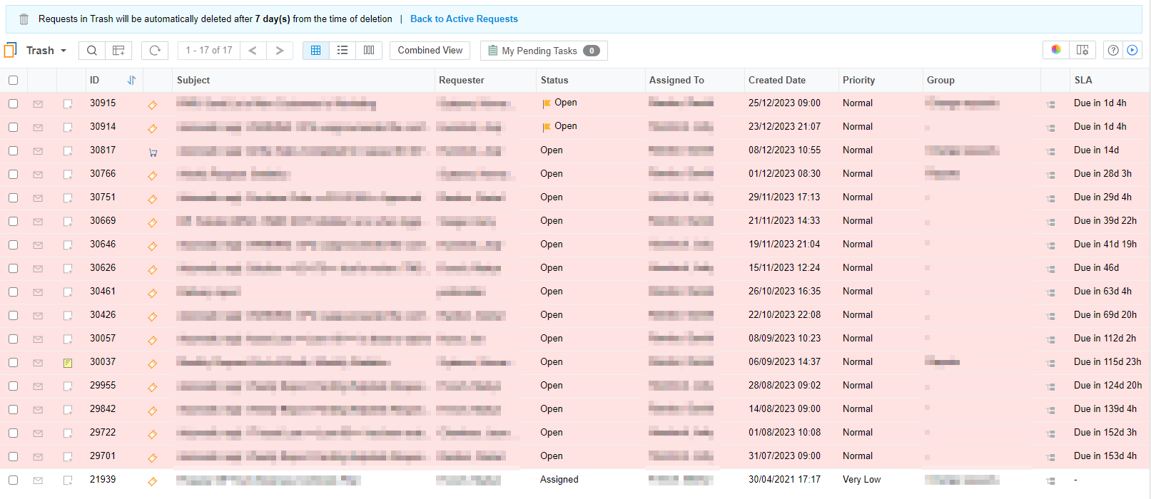

The problem has been exacerbated by the fact that Deleted Requests are not being deleted after 7 days as they should be (and used to be). See below screenshot. I have not looked into this further, but I presume this is a bug introduced in the current version we are running (14304) and is likely fixed with an update. It is not an issue anyway, but I do need to exclude these "Open" deleted items from the Pending Request report. Of course, I can delete them from Trash manually but the problem will occur again.
