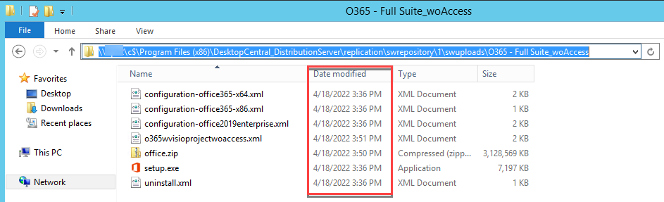

Can someone point me in the right direction on what i'm doing wrong?  I have configured a job to deploy O365 local to the machines in our environment.  The job will then replicate to the Remote Office Distribution Server correctly, and then deploy to the machine in that Remote Office.  The PROBLEM is, the next time I deploy the same piece of software, whether to the same machine or to a different one in the SAME Remote Office, the software will re-replicate all over again.  I can't have this happen to every job that I push out.  This is affecting every Remote Office Distribution Server in our environment.  My understanding is when the software is replicated to the Distribution Server, any subsequent push, would take the software package from the Distribution Server directly and therefore no replication should happen from the Central Server Local Office, as the software is already there.
This is happening to any Configuration/Software Deployment I create/push.
Hopefully I can get an answer as to what i'm doing wrong.  Thanks!
First job (Replication occurred):
Second job (Re-replicated - Why?):
