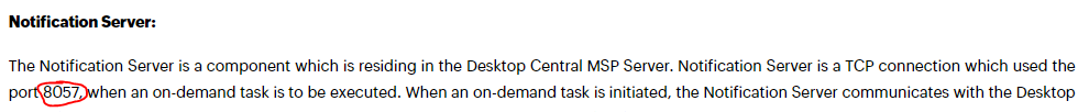

The issue is that I saw that he was trying to communicate on port 8027, whereas it is specified on the Desktop Central MSP Architecture that it is supposed to communicate on port 8057

Is there a way to tell my agent to communicate with port 8057 instead of 8027, and why is it trying to do it on port 8027 in the first place ?
