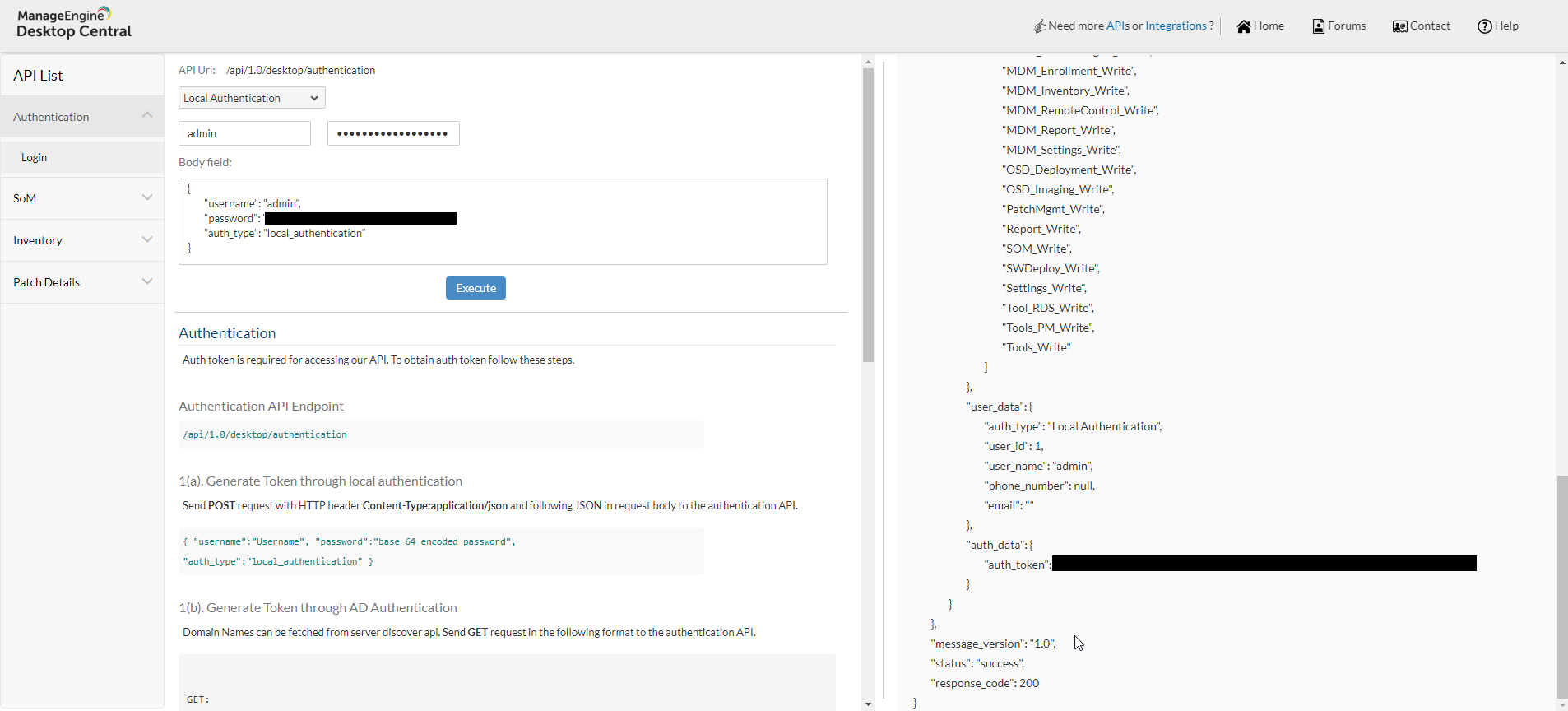

Authentication does work when I go to Admin > API Explorer, then choose Authentication > Login from the left, Local Authentication, then enter my credentials.
