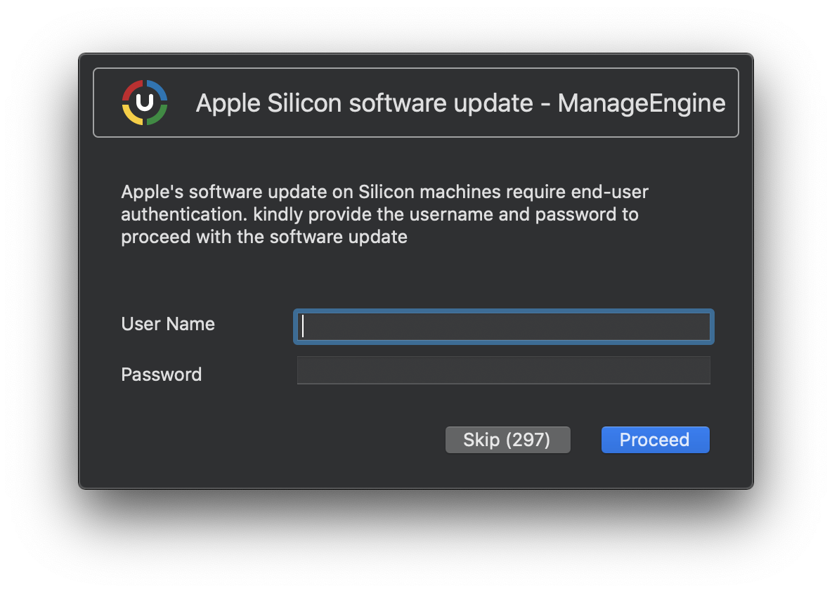

macOS 12 Monterey updates, however, can be deployed to the Silicon machines by the system admins. But, they need to be authenticated by the end-user (by providing user name and password) for the installation to be successful on client Silicon machines.
The end-user authentication prompt looks like the picture given below
