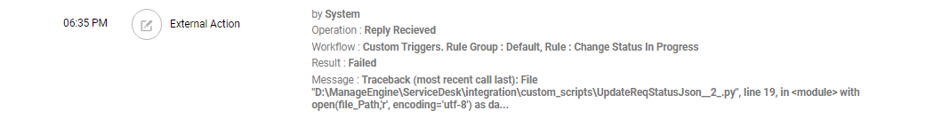

I have been in contact with SDP support and they send us the attached script but it still does not work. the error we received are something like this : (from the ticket history) :
Same error on system log:
External action failure.
Entity Id : 152426.
Operation: Reply Recieved.
Workflow: Custom Triggers. Rule Group : Default, Rule : Change Status In Progress.
Result: Failed.
Message: Traceback (most recent call last):
  File "D:\ManageEngine\ServiceDesk\integration\custom_scripts\UpdateReqStatusJson__2_.py", line 19, in <module>
    with open(file_Path,'r', encoding='utf-8') as da....
