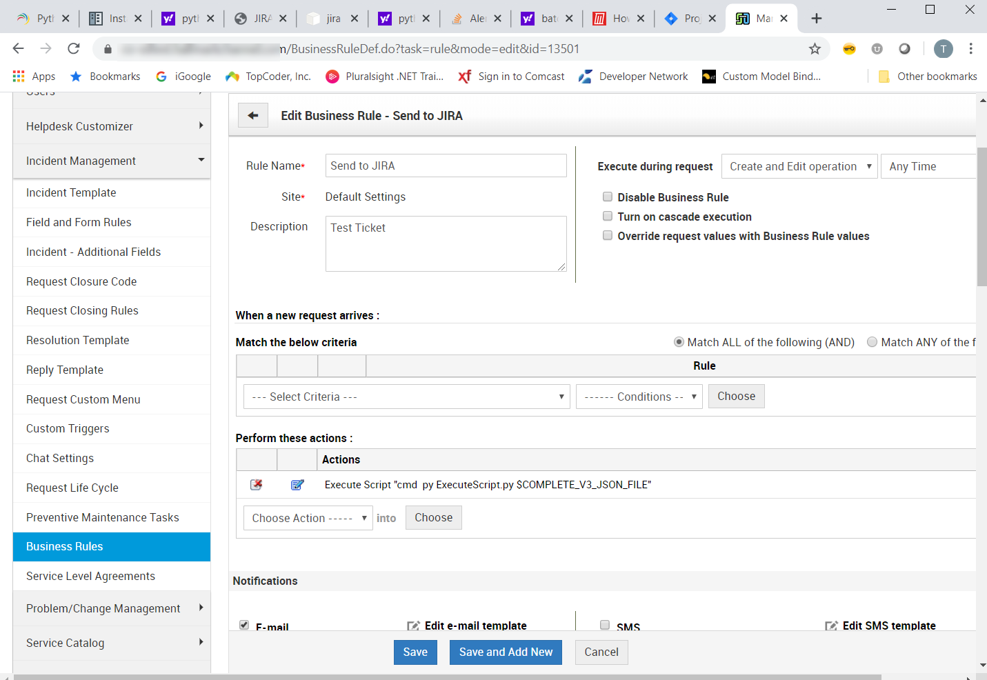

I have created a business rule to create a task in JIRA whenever an issue is created in SD+. I would like to create the script either in Python or PowerShell.
So far, I have a simple python script that should just execute and call the JIRA API, at this point just for testing it looks like this:

I don't see any indication that this ever gets called, although the business rule is set up to email the technician after execution (myself) and that is working.
Does anyone have a working example of something similar to what I'm trying to do, or have any idea, documentation etc. on how to get this working?
For the execute script I have tried 2 different approaches:
Execute Script "cmd  py ExecuteScript.py $COMPLETE_V3_JSON_FILE"
and
Execute Script "cmd ExecuteScript.py $COMPLETE_V3_JSON_FIL
but nothing seems to happen.
