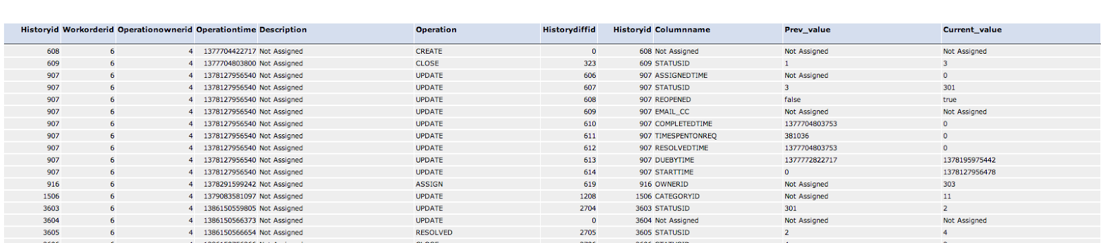

The basic premise seems straightforward enough as all the information is contained in the history tab of a request in ManageEngine ServiceDesk Plus - a copy of the result they were looking to achieve describes the required information nicely:
The key challenge here relates to the fact that the history detail often contains a range of other detail we do not require as part of this report. There are three principle data tables we require, 'workorderhistory' the key table, 'workorderhistorydiff' with the history change information and 'statusdefinition' with the status labels.
If you run the following custom query* which joins the 'workorderhistory' and 'workorderhistorydiff' data tables for a particular request ID in ManageEngine ServiceDesk Plus (just replace the number at the end of the query with your target request ID) you can get a clearer picture of the search functions you're going to need:

We worked out the following search criteria was needed to obtain the require records in our report, the two key columns being 'Operation' from the 'workortderhistory' (woh) data table and 'Columnname' from the 'workorderhistorydiff' (wohd) data table:
WHERE (((woh.Operation='CREATE' AND wohd.Columnname IS NULL) OR woh.Operation='RESOLVED' OR woh.Operation='CLOSE') OR (woh.Operation='UPDATE' AND wohd.Columnname='STATUSID'))
Once we have the right records we can then look to join the 'StatusDefinition' data table on wohd.Current_value. One slight issue that needs to be overcome is the fact that this value is stored as text rather than an integer so it need to be converted in our query.
The other challenge we need to overcome is to include a column in each row that presents the 'Operationtime' of the previous row so we can calculate the time between the various states, the first row would contain a NULL value for this.
