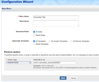

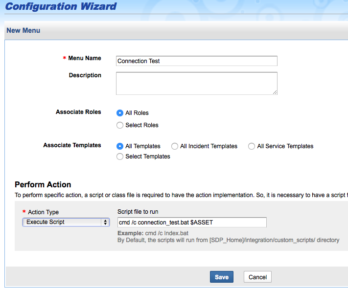

To configure a custom menu option on the Actions menu of a request we need to navigate to Admin > Request Custom Menu:
For simplicity we decided to stick with an Action Type of a simple batch file for now but you can also run class script if necessary:
You'll notice that we were able to pass the details of the asset associated with the request using the $ASSET parameter. You could of course pass pretty much any of the parameters of the request in this fashion e.g. $SUBJECT, $PRIORITY. The full instruction used is as follows:
cmd /c connection_test.bat $ASSET
