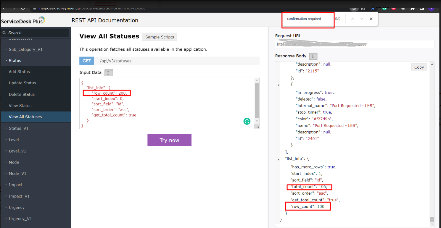

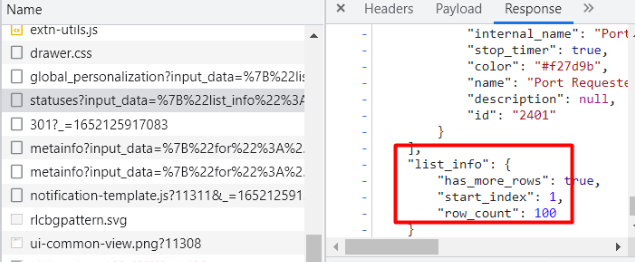

On a different note that's possibly related, I noticed that there is an issue when editing RLCs in the admin panel. Our RLC editor will not populate any newly made statuses in the selection menu. I investigated in the inspector and found that statuses? request returns a list of all statuses that is limited to 100 rows. We have 106 statuses, so some are missing, and we can't add them to RLCs.
I can replicate this issue in your API documentation page. Even when i set the row count high, the results are limited to 100.

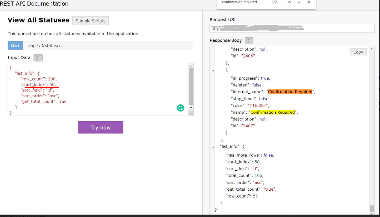

I have to increase the start index in order to find the 'confirmation requested' status.
