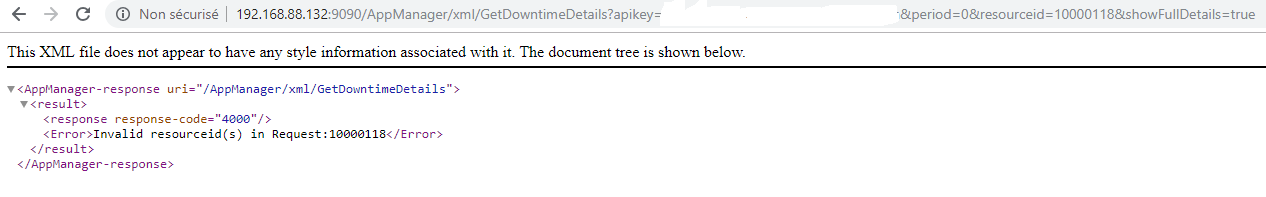

I have a problem with REST API « GetDowntimeDetails ».  I use it to retreive downtime for monitor and for child monitor (for example a process inside a Linux Monitor).
On my previous version 13580, it works for both monitor type. After updating in 14050 : it works for monitor but it does not work for children anymore. I get an error « Invalid resourceid(s) in Request » in my XML file.

URL Sample :
http://192.XXX.XX.XXX:9090/AppManager/xml/GetDowntimeDetails?apikey=xxxx&period=0&resourceid=10000118&showFullDetails=true
 I also did tests with the parameter "type = [value]", without success.
