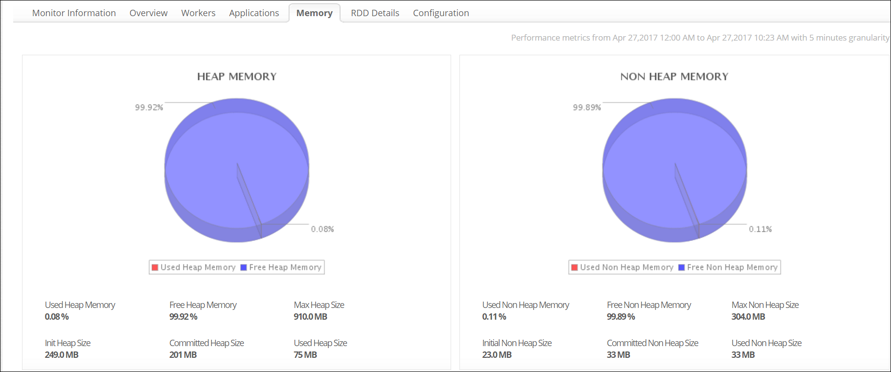

1. Memory: This has to be the first obvious problem. You might have often found yourself at the receiving end of Driver errors or Execute errors. This usually happens when the driver or executor has been configured with a memory limit that is not sufficient for the application to run. Generally, while moving from standalone cluster mode to YARN and Mesos, memory issues such as these could be common. On a side note, remember to distribute, instead of running everything on the local node.
