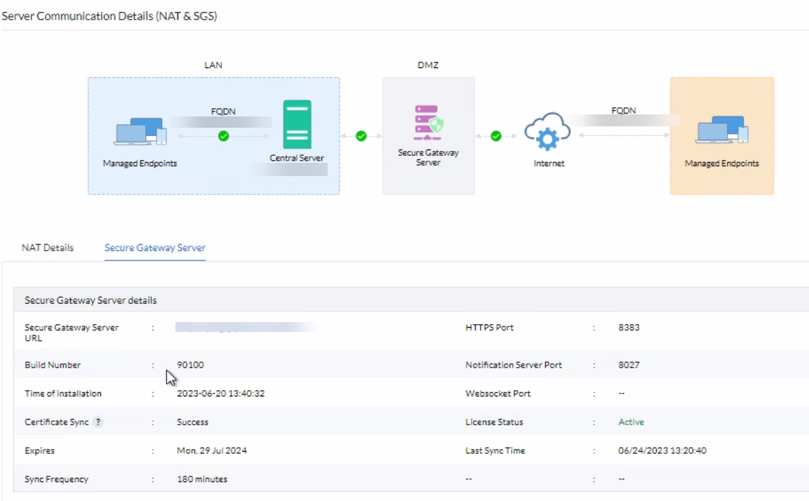

Secure Gateway screenshot:

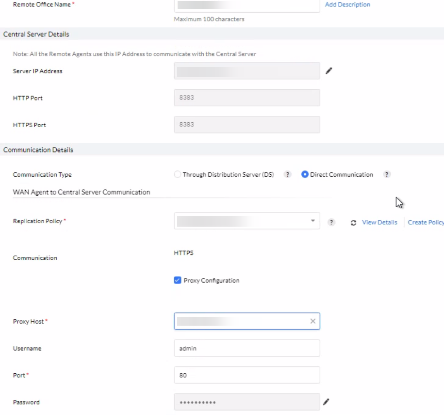

Remote Office screenshot:

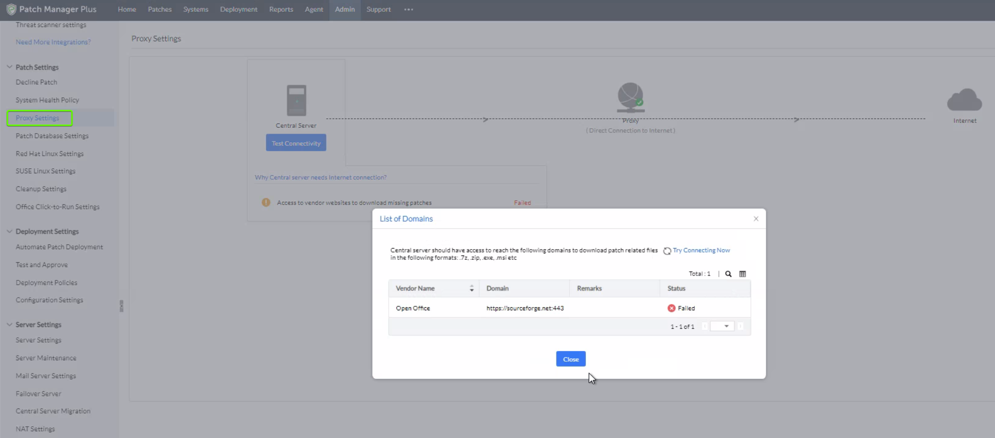

Proxy Settings screenshot:
